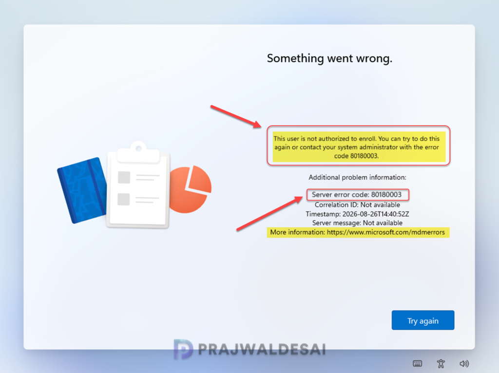

The below image shows the actual MDM enrollment error with some additional details that are presented to the user during the autopilot device enrollment phase.
“Something went wrong. This user is not authorized to enroll. You can try to do this again or contact your system administrator with the error code 80180003.”
If you choose Try again, the device restarts and the user sees the sign-in screen, but after entering your credentials, the same error appears.
Autopilot Device Enrollment Error 80180003

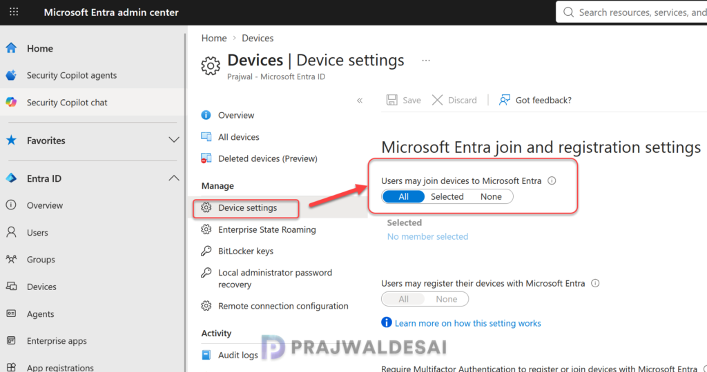

Solution 1: Confirm the user can join devices to Microsoft Entra ID
Sign in to the Microsoft Entra admin center with an administrator account. Go to Entra ID > Devices > Manage > Device settings. Under the section ‘Users may join devices to Microsoft Entra‘, choose either All or Selected and select the users who you want to allow permission to enroll devices to Microsoft Entra. Click Save to apply the changes.
The next time a user tries to join the device to Microsoft Entra, it should proceed seamlessly without the 80180003 error occurring. Jump to the next solution if this didn’t work for you.
Confirm the user can join devices to Entra ID

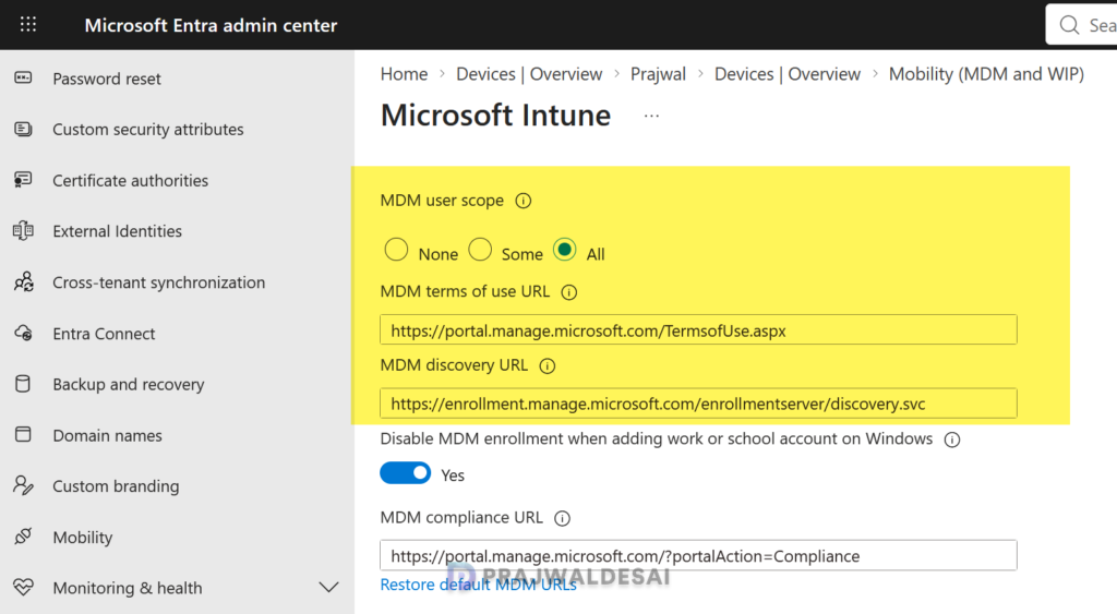

Solution 2: Verify Windows Automatic Enrollment
The MDM user scope in Microsoft Entra ID is a setting that determines which users can automatically enroll their Windows devices into an MDM provider like Microsoft Intune when joining or registering the device. If the user hasn’t been assigned with the correct scope or is restricted from enrollment, you may encounter failures such as error 80180003 during device provisioning.
To check the MDM user scope, sign in to the Microsoft Entra admin center. Go to Entra ID > Mobility and select Microsoft Intune. Under MDM user scope, you have three options for selection.
  • None: Automatic MDM enrollment is disabled for all users.
  • Some: Automatic MDM enrollment is enabled for the users you select.
  • All: Automatic MDM enrollment is enabled for all users. Their devices automatically enroll in Intune when they join or register with Microsoft Entra ID.
Select All or Some to allow Entra users to automatically enroll their Windows devices into Intune. Save the changes you’ve made. The user should now have enough permission to enroll the device into Intune.
Verify Windows Automatic Enrollment in Entra

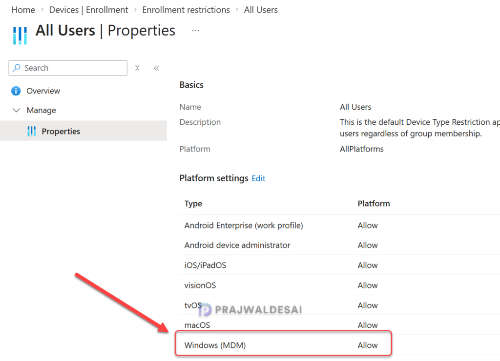

Solution 3: Check Device Platform Restrictions
If multiple users are seeing error 80180003 during device enrollment, you must verify if the Windows devices are allowed for MDM enrollment. To check that, sign in to the Microsoft Intune admin center and navigate to Devices > Enrollment > Device platform restrictions. Under Windows restrictions, select the restriction policy > Platform settings and ensure Windows (MDM) devices are allowed for enrollment. See the below image for reference.
Check Device Platform Restrictions in Intune for Enrollment Error 80180003

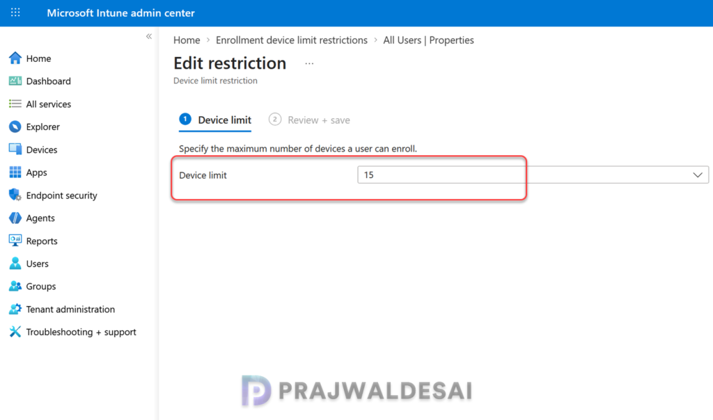

Solution 5: Check Device Limit Restrictions
One of the primary reasons why users encounter error 80180003 during Autopilot enrollment is due to the device limit restrictions. Intune lets you configure a limit on the number of devices a user can enroll and the device limit you can specify is between 1 and 15. If the device enrollment is blocked by device type restrictions or if the user’s enrollment limit is set low, attempting to enroll an additional device results in a failure with the error code 80180003.
To check the device limit restrictions in the Intune admin center, go to Devices > Enrollment > Enrollment options > Device limit restriction. Select the existing device limit restriction profile and edit the device limits and specify how many devices each user can enroll. In the below image, the users have been defined with a maximum limit of 15 devices for enrollment.
If a user has already enrolled 15 devices in the past, you may have to go to the previously enrolled devices and remove the unused ones to proceed further. See how to delete Windows Autopilot device via different options.

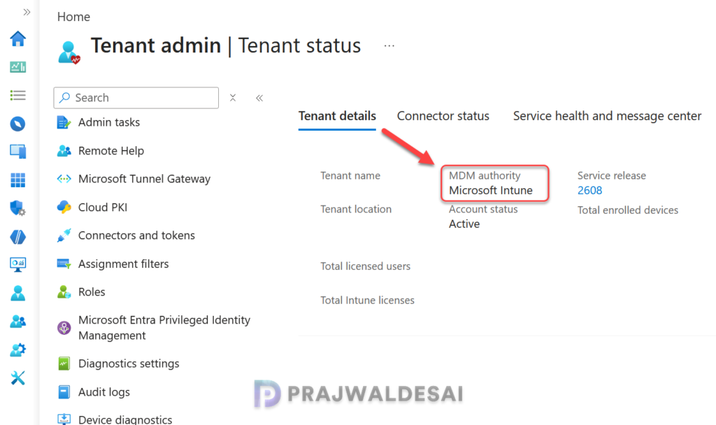

Solution 6: Set MDM Authority to Microsoft Intune
The mobile device management (MDM) authority setting determines how you manage your devices. You must set an MDM authority to Microsoft Intune before users can enroll devices for management. If your MDM authority shows as Unknown, then the device enrollment will fail with error code 80180003. For more information, see how to set MDM authority.
You can check your tenant’s Mobile Device Management (MDM) authority by navigating to Tenant administration > Tenant status in the Microsoft Intune admin center. In the below image, the MDM authority is set to Microsoft Intune.
