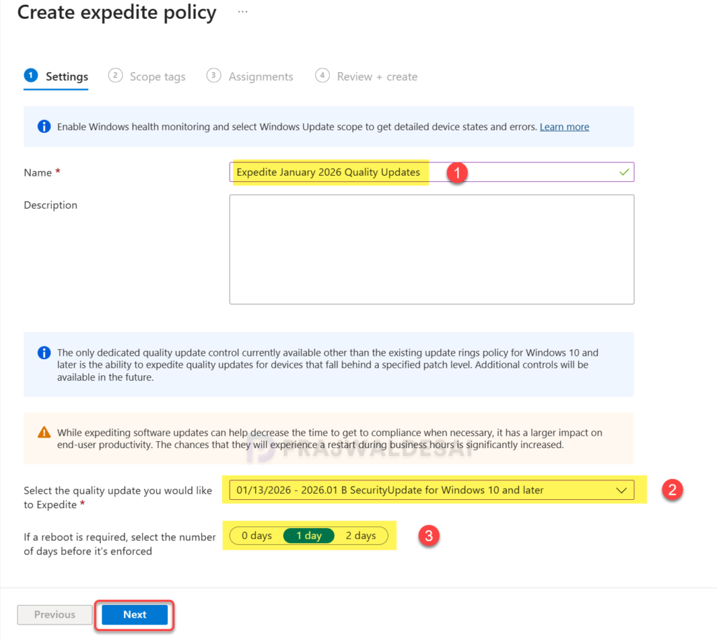

In the Settings tab, enter the following properties to identify this profile:
  1. Name: Enter a descriptive name for the profile.
  2. Description: Enter a brief description for the profile.
  3. Select the quality update you would like to expedite: Select the Windows quality update that you want to expedite from the drop-down list.
  4. If a reboot is required, select the number of days before it’s enforced: Choose how soon a device will automatically restart to finalize the update installation after it has been installed. Options range from zero to two days.
    • Enforce reboot in 0 days: Selecting 0 days means the device will notify the user about the restart immediately after the update is installed, allowing them limited time to save their work.
    • Enforce reboot in 1 or 2 days: Choosing 1 or 2 days allows users more flexibility to manage the restart before it becomes mandatory. These options correspond to an automatic restart delay of 24 or 48 hours after the update is installed.
Click Next to continue.

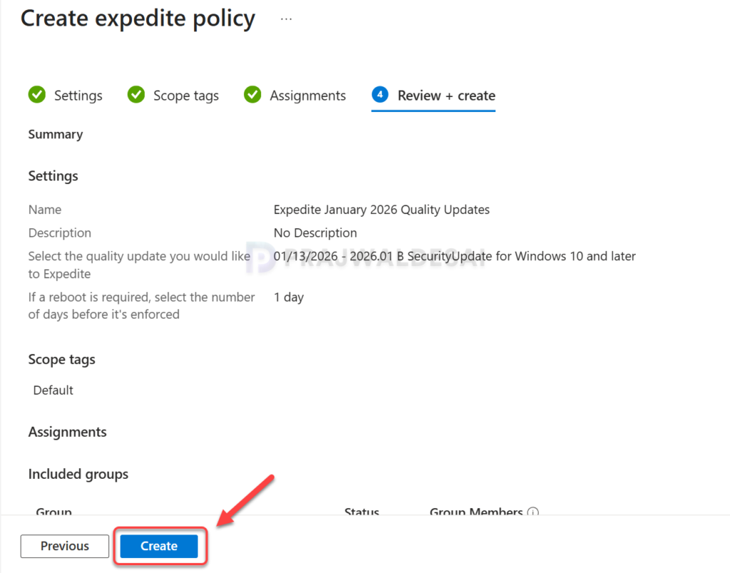

In Review + create, select Create. After the expedite policy is created, it is deployed to assigned groups. A notification will also appear in the top-right corner of the portal indicating that the expedited policy is successfully created.
The expedited updates will start installing after the device completes its next update scan and communicates with the service.

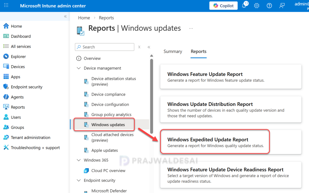

Windows Expedited Update Report
This is a useful report that shows the current status of all devices within the profile, providing a summary of how many devices are in the process of installing an update, have successfully completed the installation, or have encountered an error. Here’s how you can locate and generate this report.
Sign in to the Microsoft Intune admin center. Select Reports > Windows updates. Switch to the Reports tab, and then select Windows Expedited Update Report as shown in the below image.

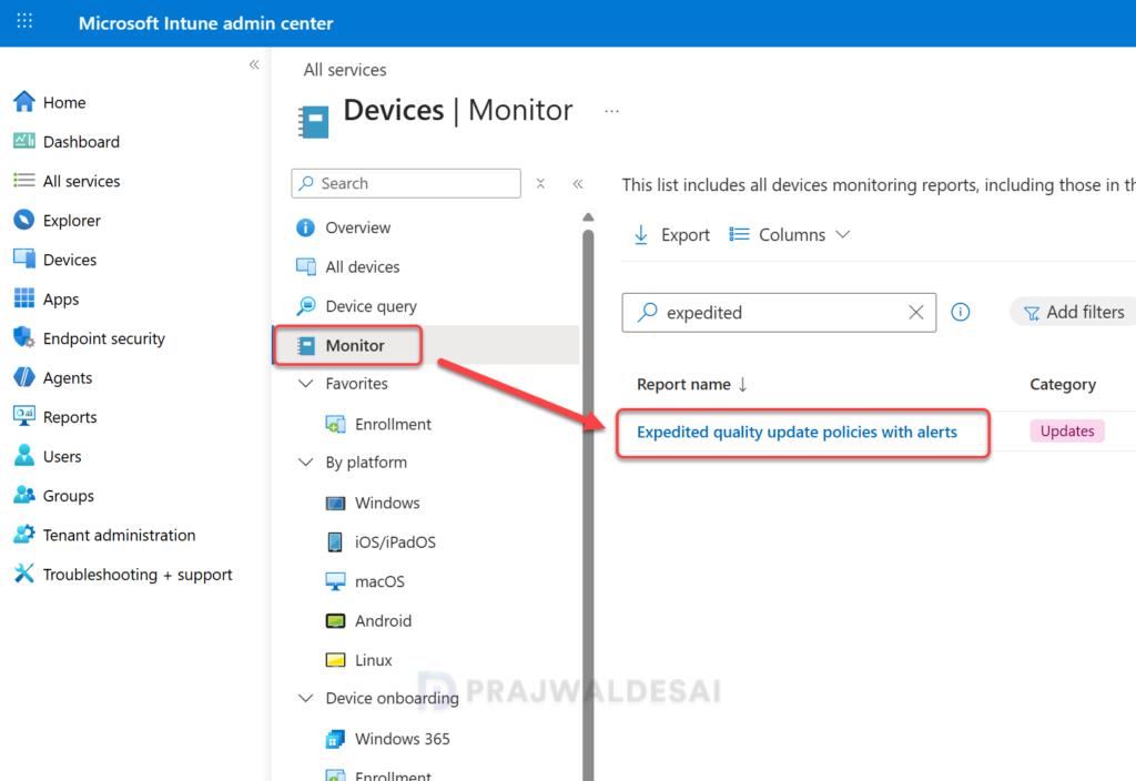

Expedited Quality Update policies with alerts
The Windows Expedited Update failures report can help you find devices with alerts or errors and can help you troubleshoot update issues.
Sign in to the Microsoft Intune admin center. Select Devices > Monitor. In the list of monitoring reports, scroll to the software updates section and select Expedited quality update policies with alerts. From the list of profiles that is shown on the right side of the page, select a profile to see the results.

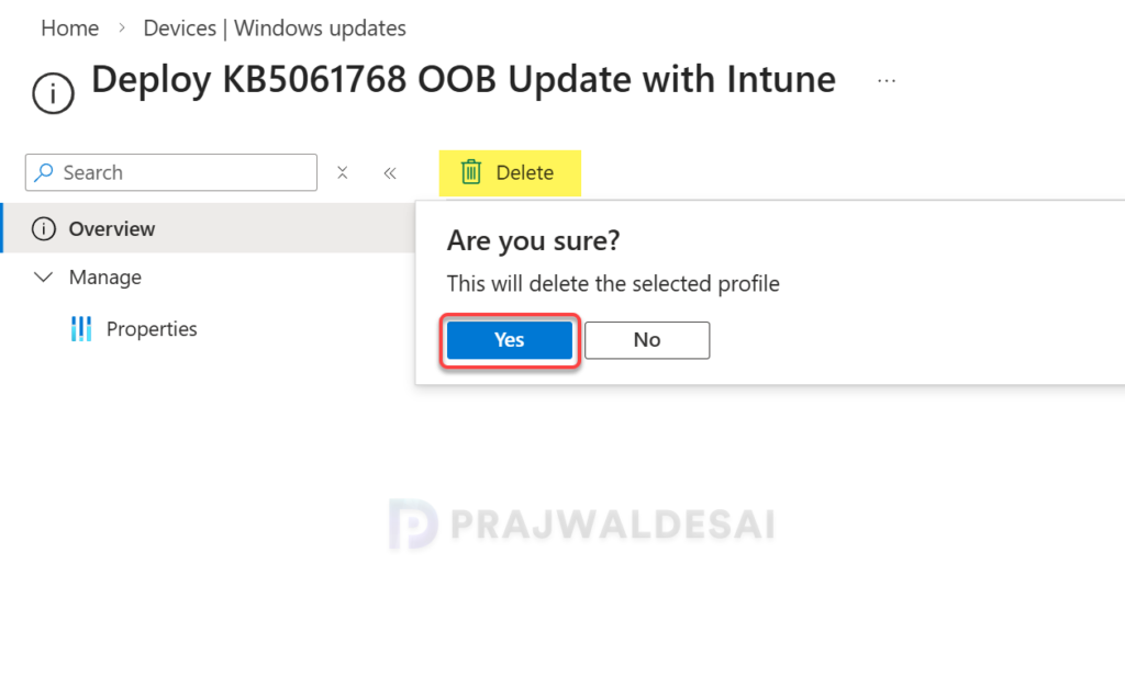

Delete an Expedite Policy
Administrators can delete an existing expedite policy from the Intune admin center if it’s not required anymore. Remember that deleting a policy removes it from Intune but won’t result in the update uninstalling if it has already completed installation. However, if the quality update has not yet been installed, Windows Update will ‘try‘ to cancel any ongoing installations.
To delete an expedite policy in Intune, go to Devices > Manage updates > Quality updates tab. Select the expedited update policy and click on Delete. Click Yes to confirm the deletion.
