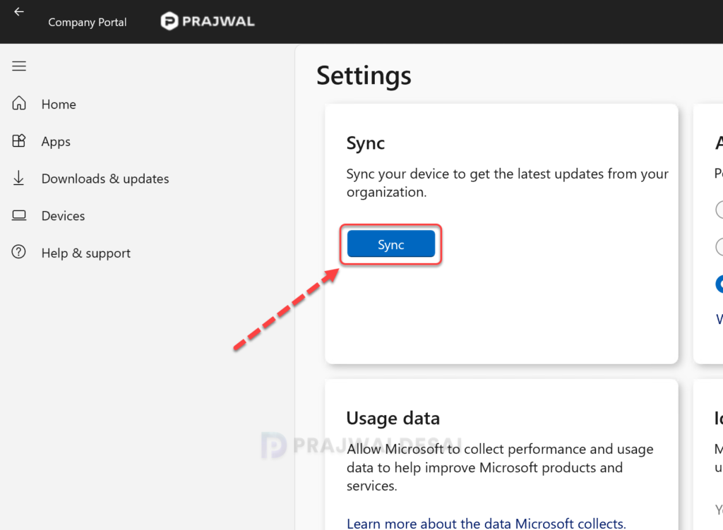

Method 2: Sync Intune Policies via Company Portal App
End users can quickly initiate the sync via the Company Portal app on Windows PC. To accomplish that, click on your Start Menu (or press the button on your keyboard) and then open the Company Portal app. Once the Company Portal has loaded, select the Settings icon from the left-hand navigation bar, and then click the Sync button.

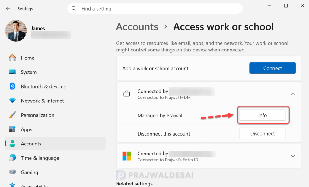

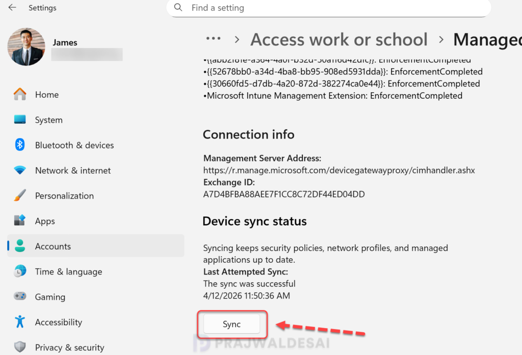

Method 4: Perform Intune Sync using Settings App
You can manually sync to refresh Intune policies on Windows devices using the Settings App. On your device, select Start > Settings. Select Accounts. Under Accounts, select Access Work or School. Select the account that has a briefcase icon next to it. Click Info.
Under Device Action Status, select Sync. This will sync the latest security policies, network profiles and managed applications from Intune. In the same window, you should find the last attempted sync date and time.

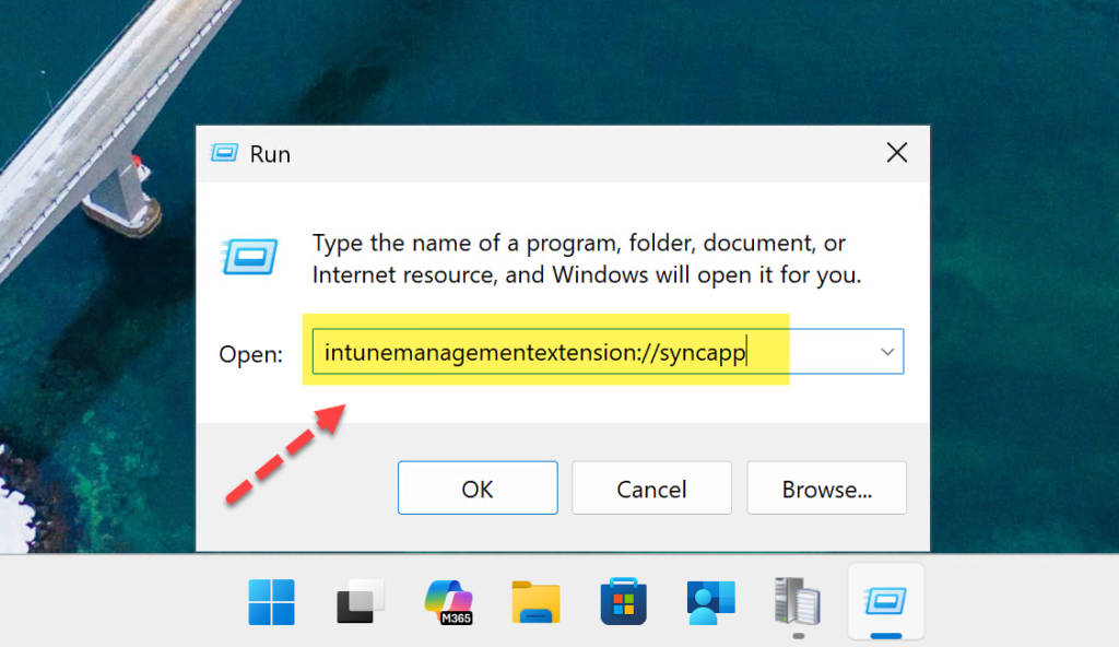

Method 8: Trigger Sync via Intune Management Extension SyncApp
My MVP friend, Oliver kieselbach, discovered that when you trigger a sync via the Company Portal app, it also triggers IME to start a Sync process. Upon reviewing the IME logs, it is evident that the IME receives a signal to initiate a sync process and proceeds to execute the synchronization with the intunemanagementextension://syncapp command.
To manually trigger the Intune sync on a Windows device with the above command, right-click Start, select Run. Type intunemanagementextension://syncapp and press the enter key.

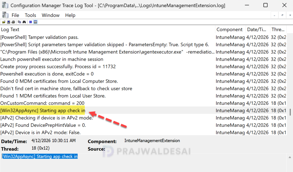

After you run the above command, open the IntuneManagementExtension.log located in C:\ProgramData\Microsoft\IntuneManagementExtension\Logs folder. Here, look for the line “[Win32AppAsync] Starting app check in” which confirms that synchronization of policies has been initiated.

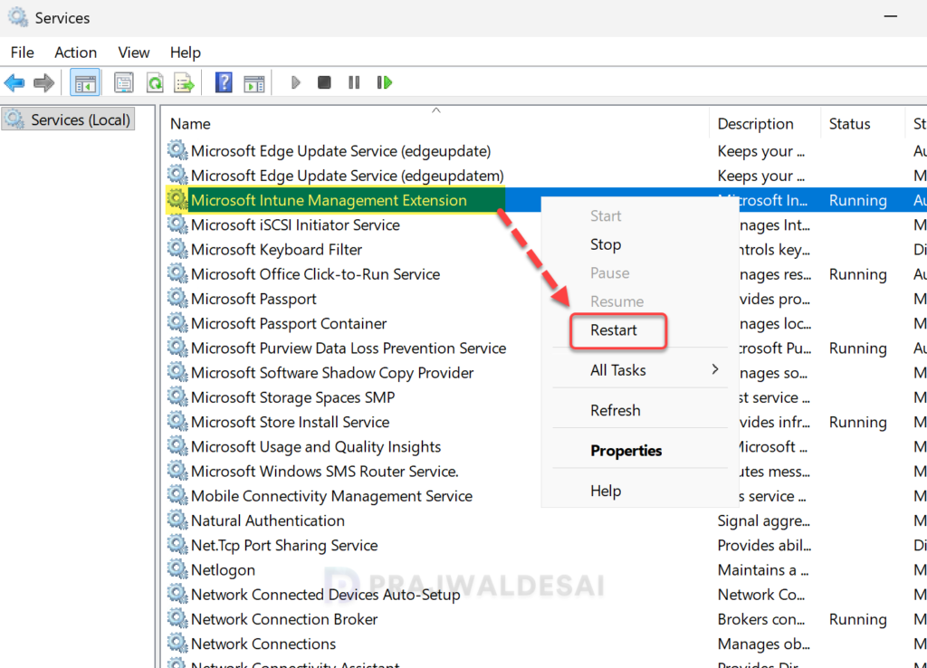

Method 9: Restart Intune Management Extension Service to Trigger Sync
If you’re in the mid of troubleshooting Win32 app installation issues or unable to see the PowerShell scripts applied via Intune, the solution is to manually restart the Intune Management Extension service. This action initiates IME to start a Sync process and the recent settings are applied to the device. To perform that, type services.msc in the Run dialog box and press the Enter key. In the Services console, right-click Microsoft Intune Management Extension and select Restart.

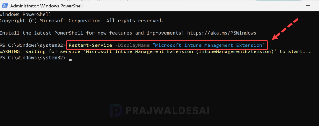

If you wish to restart the IME service using PowerShell, use the below command.
Restart-Service -DisplayName "Microsoft Intune Management Extension"

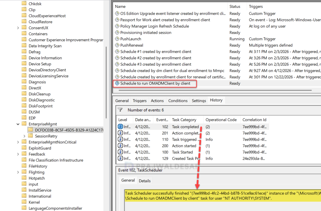

Method 10: Trigger Windows Device Sync via Task Scheduler
Task Scheduler is one of the interesting methods to trigger a sync on Windows device. If you go into the Intune admin center and select Sync action for a device or use any other methods to perform policy sync, the OMADMClient is utilized by Microsoft Intune to sync policies, settings, and updates.
To locate the Schedule task created for OMADMClient, launch the Task Scheduler and navigate to Microsoft > Windows > EnterpriseMgmt. Here expand the GUID folder and within this folder you’ll find the scheduled task “Schedule to run OMADMClient by client“.
To manually trigger the Windows device sync, right-click Schedule to run OMADMClient by client task and select Run. The task status changes to running and in the background the latest policies and settings are updated on the device.
Task Scheduler successfully finished "{7ee999bd-4fc2-44bd-b878-51ce9ac61ece}" instance of the "\Microsoft\Windows\EnterpriseMgmt\Device Enrollment GUID\Schedule to run OMADMClient by client" task for user "NT AUTHORITY\SYSTEM".
The Event ID 102 indicates the sync task scheduler job has been completed successfully. Return code 0 indicates that the Intune policy sync is successful on the given device.
Task Scheduler successfully completed task "\Microsoft\Windows\EnterpriseMgmt\DCFDC03B-8C5F-45D5-B329-A1224C178DD8\Schedule to run OMADMClient by client" , instance "{7ee999bd-4fc2-44bd-b878-51ce9ac61ece}" , action "%windir%\system32\omadmclient.exe" with return code 0.

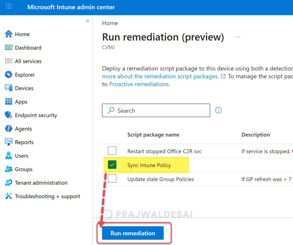

Method 11: Run Remediation to Sync Windows Device
The run remediation remote action in Microsoft Intune allows IT administrators to proactively detect and resolve support issues on managed devices. You can also use this feature to update the Intune policies on managed Windows devices.
- In the Microsoft Intune admin center, select Devices > All devices.
- From the device list, select a Windows device.
- At the top of the device overview pane, find the row of remote action icons. Select Run remediation (preview).
- In the Run remediation (preview) pane, select the Sync Intune Policy script package and click Run remediation.
