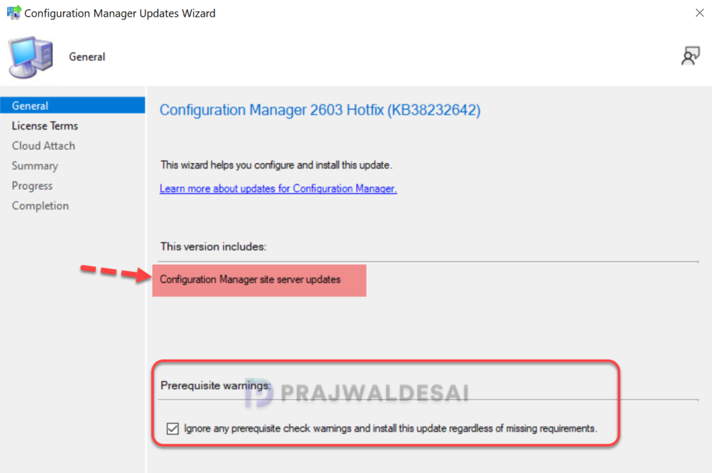

This same security update is included with the second update rollup KB37864969 for Configuration Manager version 2509. A separate out of band hotfix is not required for version 2509. The hotfix only includes updates for Configuration Manager site server. No console or client upgrades are necessary after installing this update.

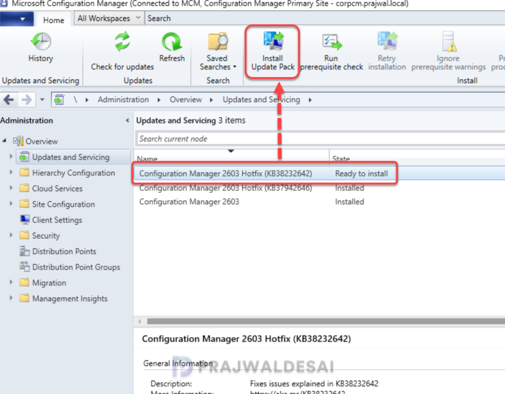

- Launch the Configuration Manager console on the server.
- Navigate to Administration\Overview\Updates and Servicing.
- Right-click Configuration Manager Hotfix (KB38232642) and select Install Update Pack.
It is highly recommended that you run a prerequisite check for this update on your production server before installing it. For lab environments, you can enable the option “Ignore any prerequisite check warnings and install the update.” Click Next.

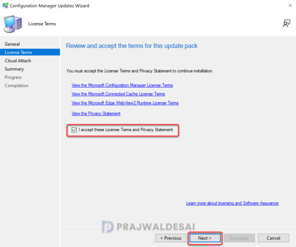

Accept the license terms required for installing the hotfix. Click Next.
Complete the steps included in the hotfix installation wizard and close the update installation wizard. The hotfix installation begins now.

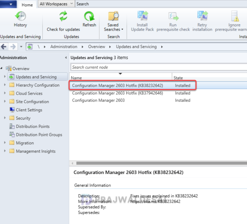

To verify if the KB38232642 hotfix is installed, open the console and go to Administration > Updates and Servicing. If the State column for the hotfix shows ‘Installed‘, it means the update installation is completed.
