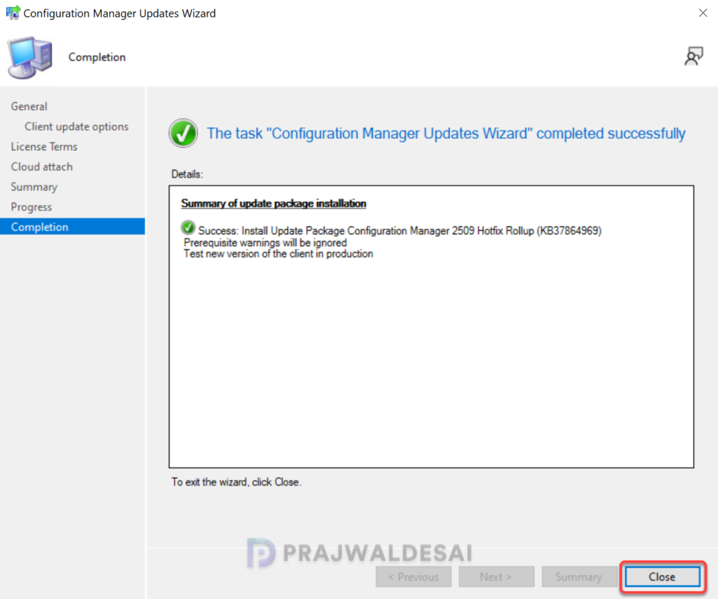

Install Configuration Manager Hotfix Rollup KB37864969

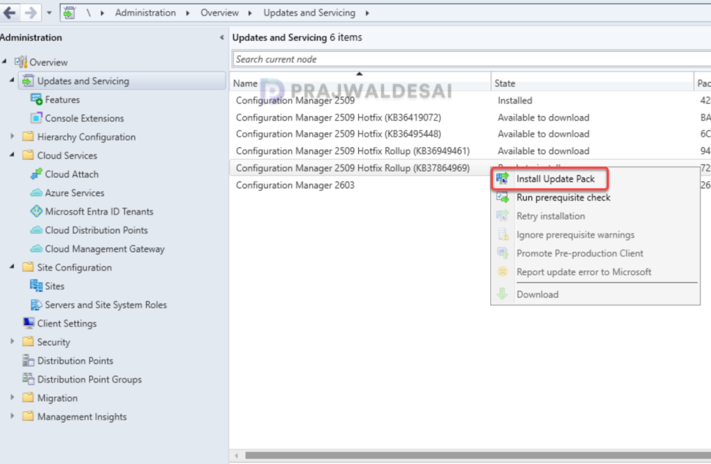

- Launch the Configuration Manager console on the server.
- Navigate to Administration\Overview\Updates and Servicing.
- Right-click Configuration Manager Hotfix Rollup (KB37864969) and select Install Update Pack.

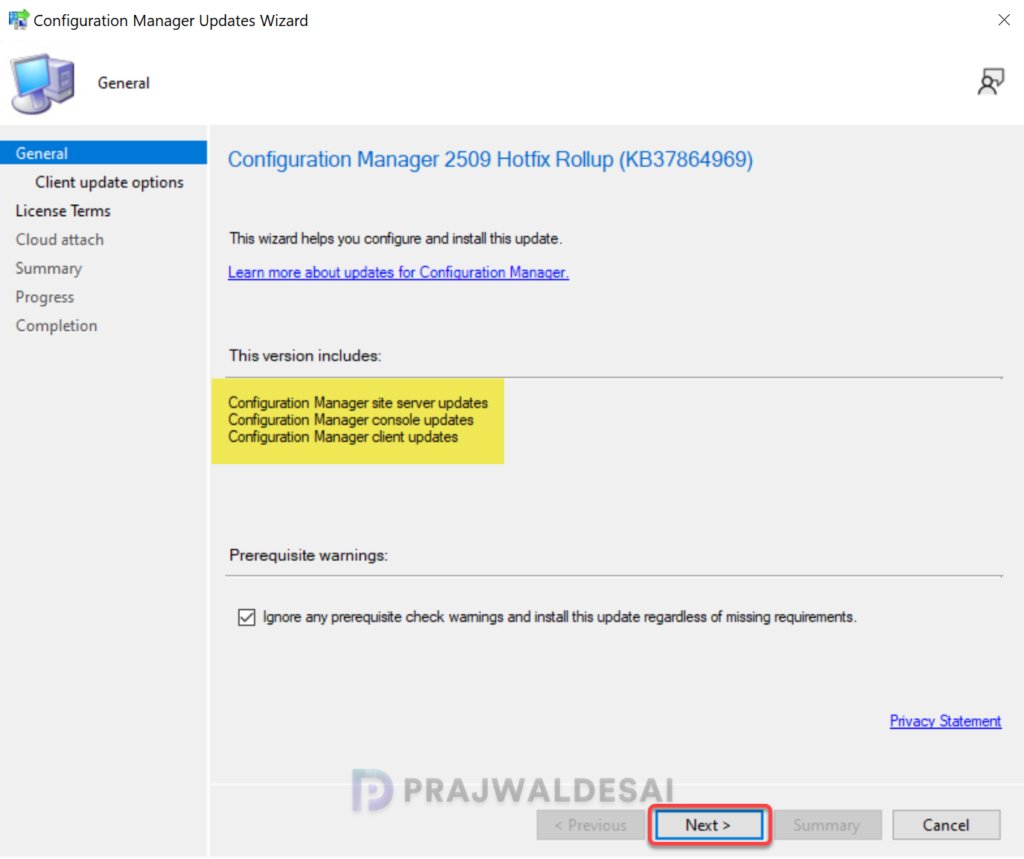

It is highly recommended that you run a prerequisite check for this update on your production server before installing it. For lab environments, you can enable the option “Ignore any prerequisite check warnings and install the update.” Click Next.

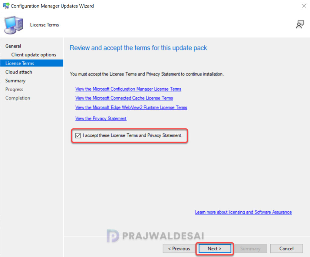

Accept the license terms required for installing the hotfix. Click Next.
Complete the steps included in the hotfix installation wizard and close the update installation wizard. Sit back and relax; the hotfix installation begins now.
Track the installation of the hotfix
To track the progress of KB37864969 hotfix installation, navigate to Monitoring\Overview\Updates and Servicing Status. If the hotfix fails to install, this section will show you the exact step where the update failed. Another way to monitor the hotfix installation progress is by reviewing the cmupdate.log file.
Console Upgrade

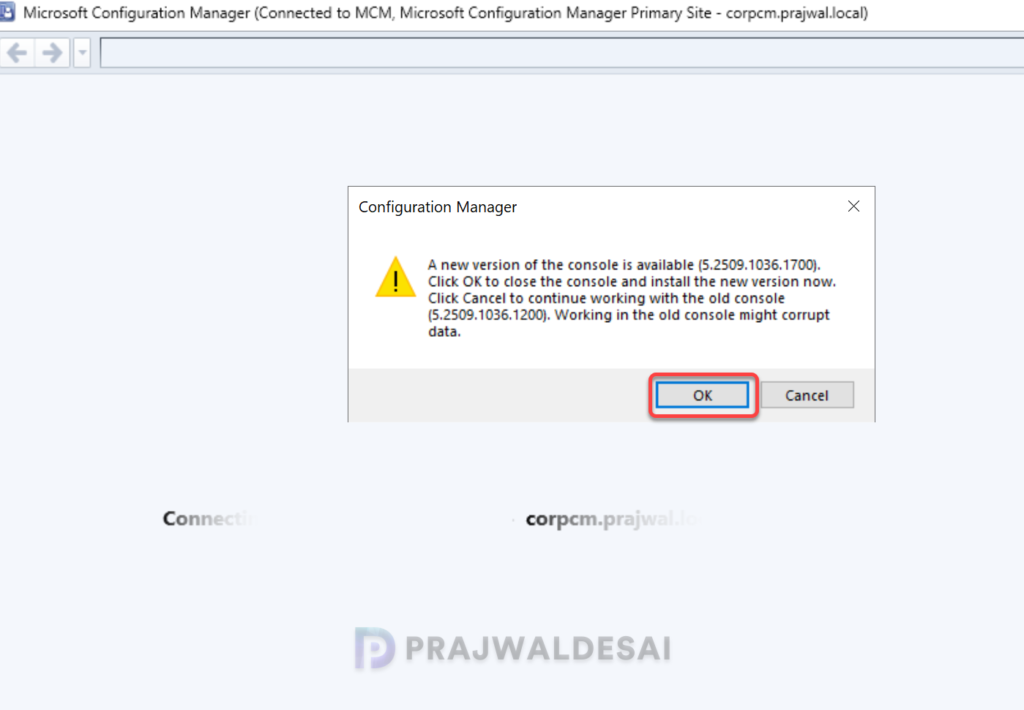

If you’re prompted for the console upgrade, complete it. The hotfix upgrades the Configuration Manager Console to version 5.2509.1036.1700. This update doesn’t require a computer restart but will initiate a site reset after installation.

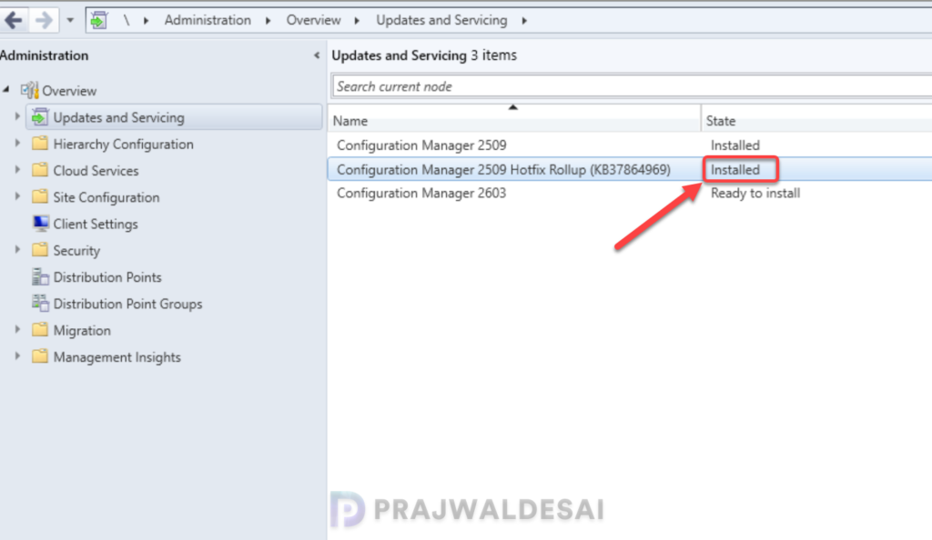

To verify if the KB37864969 hotfix is installed, open the console and go to Administration > Updates and Servicing. If the State column for the hotfix shows ‘Installed‘ it means the update installation is completed.

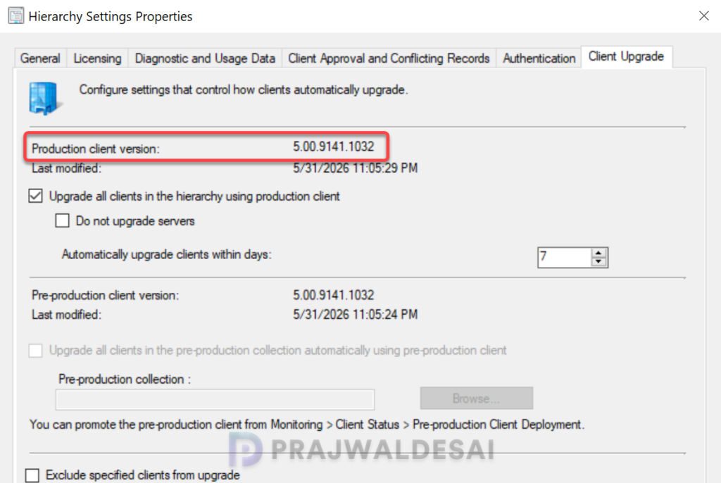

The hotfix rollup KB37864969 updates the client agent version to 5.00.9141.1032. Make sure you upgrade the clients to the latest version to get the fixes and new features. For more help on upgrading the clients, refer to the guide SCCM client upgrade options.
