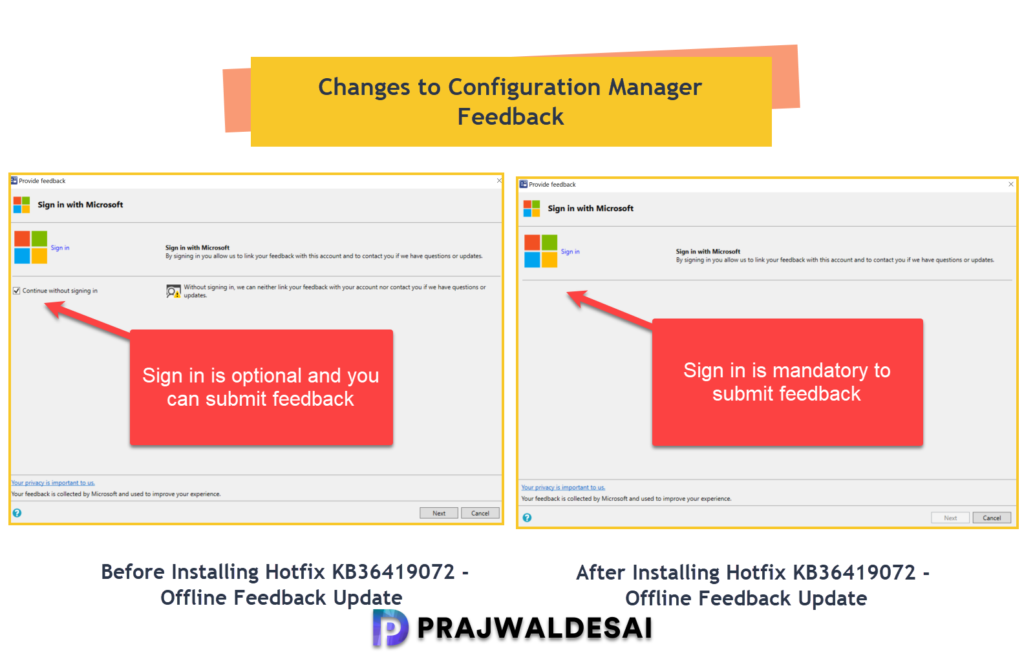

Starting 26 June 2026, when you submit feedback for Configuration Manager product, it will no longer accept unauthenticated requests. That means you’ll have to sign in either with a Microsoft account to submit the feedback.

The image below illustrates a clear comparison of authentication enforcement when submitting feedback through the Configuration Manager console. On the left, prior to installing hotfix KB36419072, users could submit feedback without signing in. On the right, after installing the KB36419072 update, users are required to sign in to submit feedback.

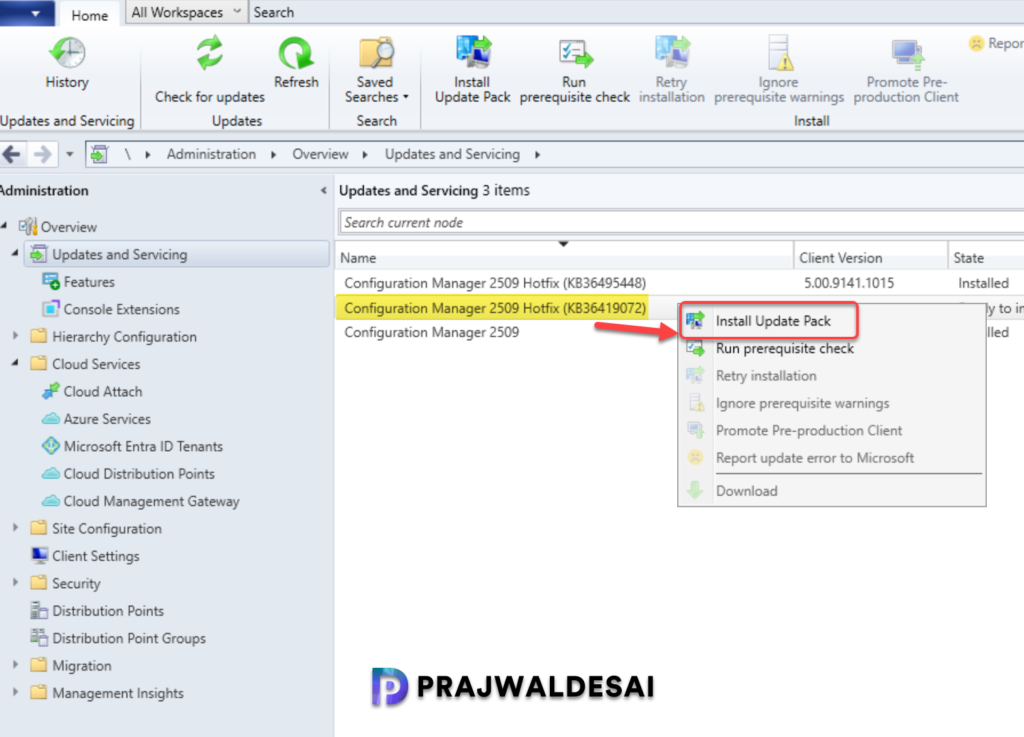

  1. Launch the Configuration Manager console on the server.
  2. Navigate to Administration\Overview\Updates and Servicing.
  3. Right-click Configuration Manager Hotfix (KB36419072) and select Install Update Pack.

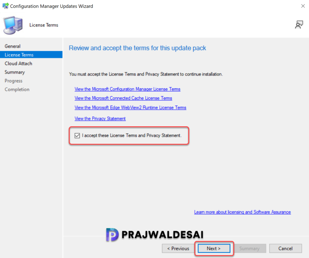

Accept the license terms required for installing the hotfix. Click Next.
Accept License terms for installing SCCM Hotfix KB36419072

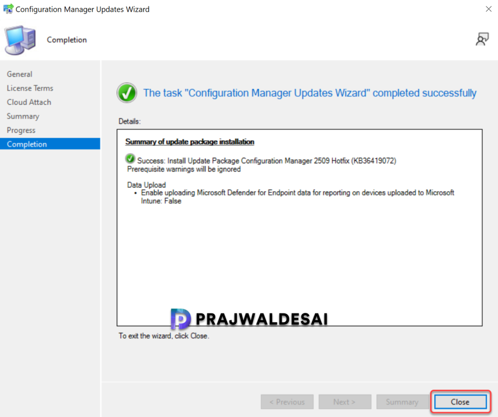

Complete the steps included in the hotfix installation wizard and wait for the hotfix to install.

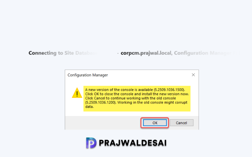

The hotfix KB36419072 upgrades the Configuration Manager console to version 5.2509.1036.1500. To upgrade the console, click on Install the new console version and complete the upgrade procedure.
Tip: During the console upgrade, review the console admin upgrade log files in case you encounter any errors.

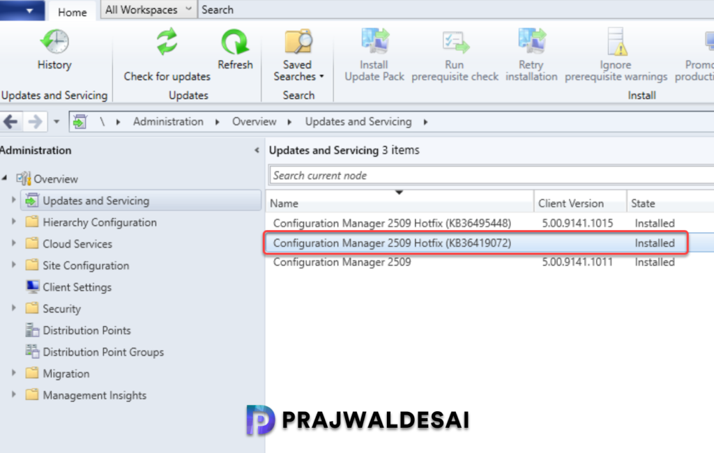

To track the progress of KB36419072 hotfix installation, navigate to Monitoring\Overview\Updates and Servicing Status. If the hotfix fails to install, this section will show you the exact step where the update failed. Another way to track the hotfix installation is by reviewing the cmupdate.log file.
To verify if the KB36419072 hotfix is installed, open the console and go to Administration > Updates and Servicing. If the State column for the hotfix shows ‘Installed‘, it means the update installation is completed.
