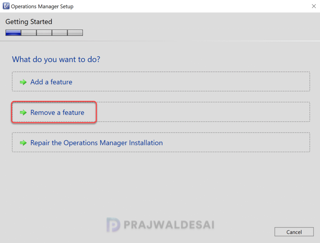

On the Operations Manager setup page, select Remove a feature.
Uninstall Operations Manager
