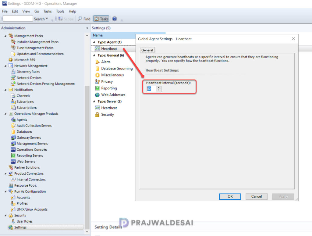

Method 1: Operations Console
You can globally change the heartbeat interval of SCOM agent from the Operations console. First, launch the Operations console and go to Administration > Settings. Right-click Heartbeat and select Properties. In the General tab of Global Agent Settings, set the heartbeat interval from 60 seconds(default) to the desired value. Click OK to save the changes.

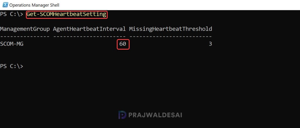

Launch the Operations Manager shell and run the below command to get the heartbeat settings for a management group.
Get-SCOMHeartbeatSettingThe command output indicates that the Agent Heartbeat Interval is set to 60 seconds. This is the default value as I mentioned earlier.

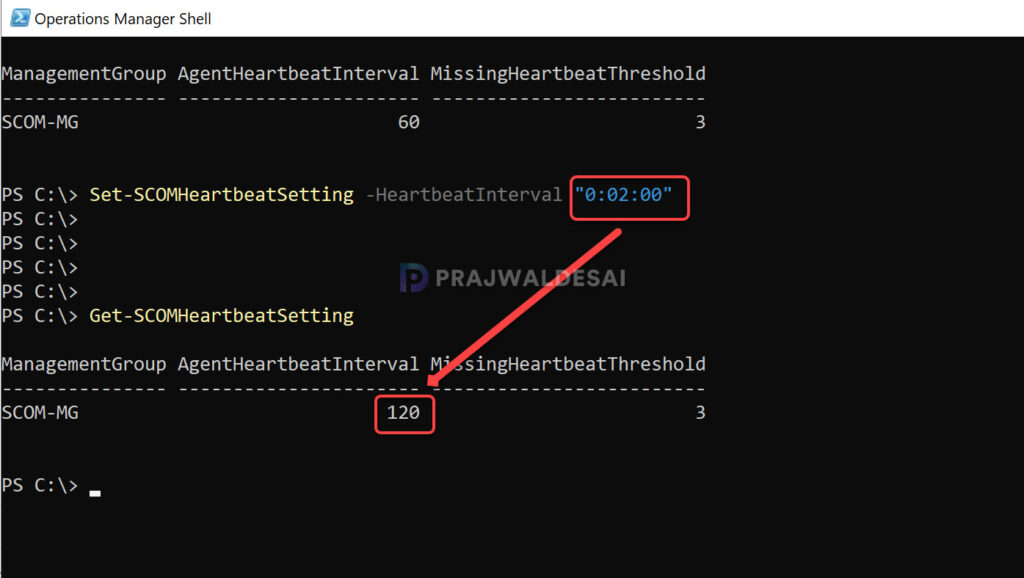

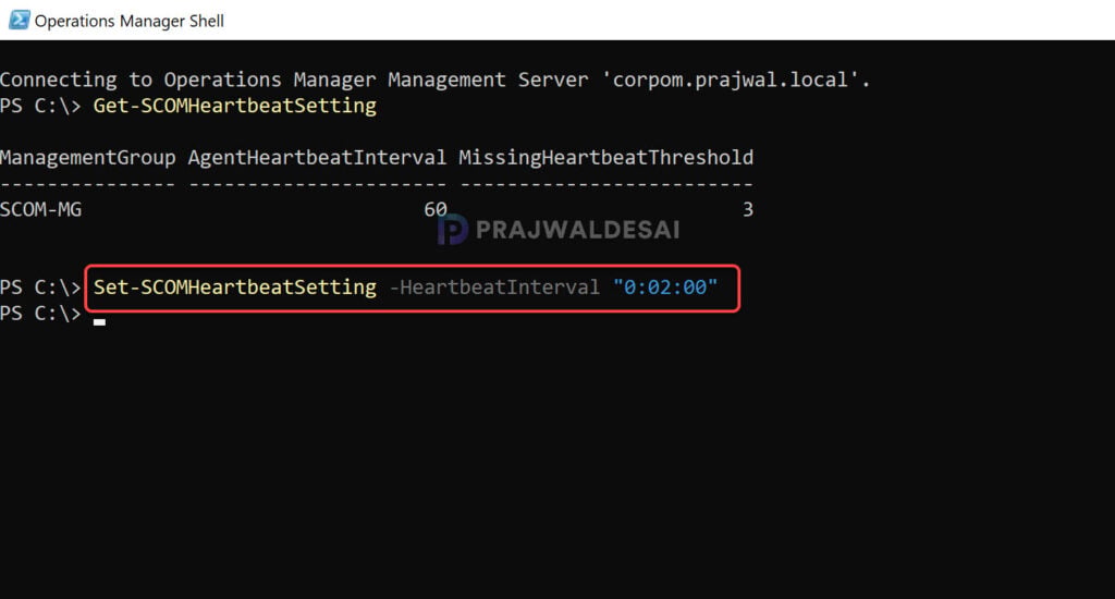

To change the heartbeat interval of agents, use the below command. In my case, the below command sets the heartbeat interval to 2 minutes (120 seconds). You can change the interval based on your requirements.
Set-SCOMHeartbeatSetting -HeartbeatInterval "0:02:00"
Run the command Get-SCOMHeartbeatSetting again and you will see that the heartbeat interval is changed to 120 seconds successfully. The changes are applied to all the agents within the specified management group.
