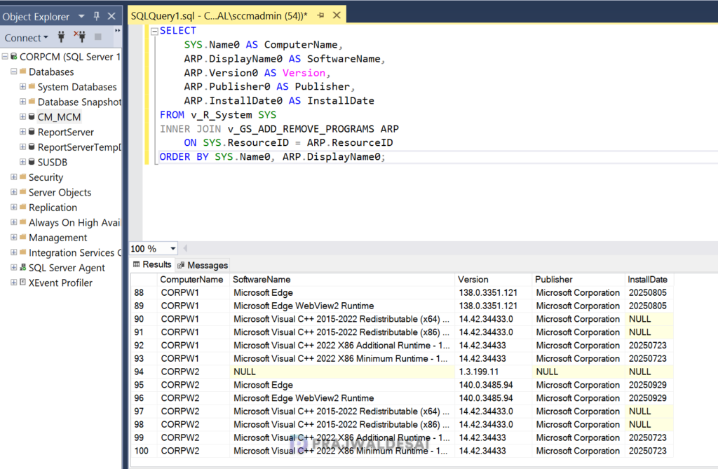

SQL Query for 32-bit Programs
The below SQL query lists all the installed 32-bit programs via add or remove programs on Windows device. The below query uses v_GS_ADD_REMOVE_PROGRAMS to list information about the 32-bit software installed on Configuration Manager client computers.
SELECT
SYS.Name0 AS ComputerName,
ARP.DisplayName0 AS SoftwareName,
ARP.Version0 AS Version,
ARP.Publisher0 AS Publisher,
ARP.InstallDate0 AS InstallDate
FROM v_R_System SYS
INNER JOIN v_GS_ADD_REMOVE_PROGRAMS ARP
ON SYS.ResourceID = ARP.ResourceID
ORDER BY SYS.Name0, ARP.DisplayName0;

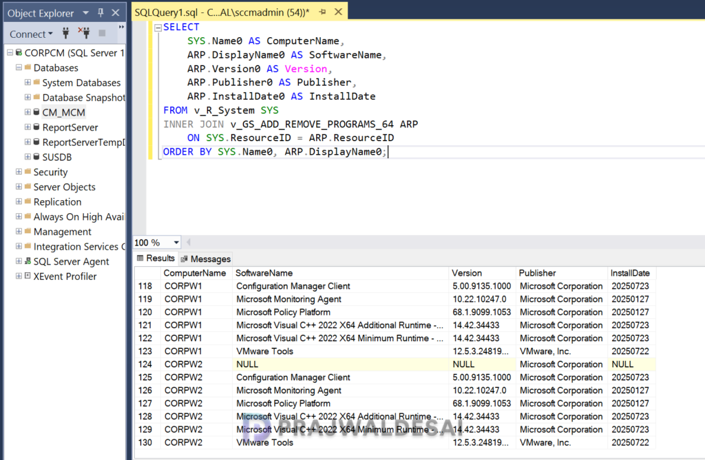

SQL Query for 64-bit Programs
Use the below SQL query to list all 64-bit programs installed on a Windows device via add or remove programs. The below query uses v_GS_ADD_REMOVE_PROGRAMS_64 to list information about the 64-bit software installed on Configuration Manager client computers.
SELECT
FROM v_R_System SYS
INNER JOIN v_GS_ADD_REMOVE_PROGRAMS_64 ARP

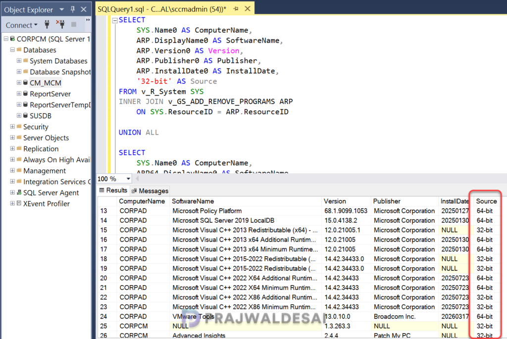

SQL Query for 32-bit and 64-bit installed programs
Here is a single query to list both 32-bit and 64-bit software programs installed on Windows computers. As you can see, it uses both v_GS_ADD_REMOVE_PROGRAMS and v_GS_ADD_REMOVE_PROGRAMS_64 to retrieve the data.
SELECT
ARP.InstallDate0 AS InstallDate,
'32-bit' AS Source
FROM v_R_System SYS
UNION ALL
SELECT
ARP64.DisplayName0 AS SoftwareName,
ARP64.Version0 AS Version,
ARP64.Publisher0 AS Publisher,
ARP64.InstallDate0 AS InstallDate,
'64-bit' AS Source
FROM v_R_System SYS
INNER JOIN v_GS_ADD_REMOVE_PROGRAMS_64 ARP64
ON SYS.ResourceID = ARP64.ResourceID
ORDER BY ComputerName, SoftwareName;

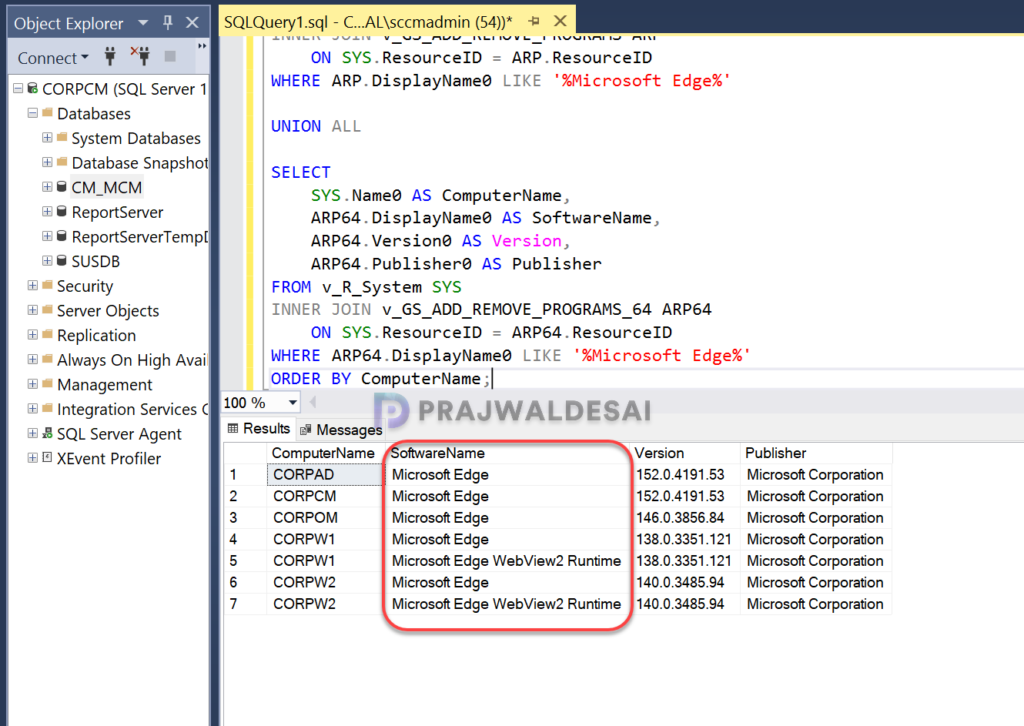

Query for a specific software title
If you’re looking to query a software using its title or name, use the below SQL query. The below query looks for Microsoft Edge installed on the devices and lists its versions along with additional information. If you’re running this query, just replace the application name with the one that you want to query.
SELECT
FROM v_R_System SYS
WHERE ARP.DisplayName0 LIKE '%Microsoft Edge%'
UNION ALL
SELECT
FROM v_R_System SYS
WHERE ARP64.DisplayName0 LIKE '%Microsoft Edge%'
ORDER BY ComputerName;

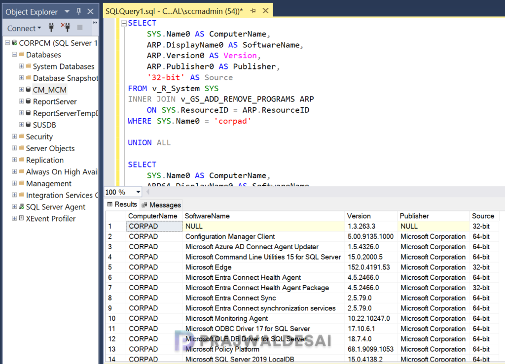

Query a single device for installed programs
If you are looking to inventory a single device to find the installed programs, then use the below SQL query. You will need to replace the value of SYS.Name0 with the computer name in the query before using it.
SELECT
'32-bit' AS Source
FROM v_R_System SYS
WHERE SYS.Name0 = 'corpad'
UNION ALL
SELECT
'64-bit' AS Source
FROM v_R_System SYS
ORDER BY SoftwareName;
