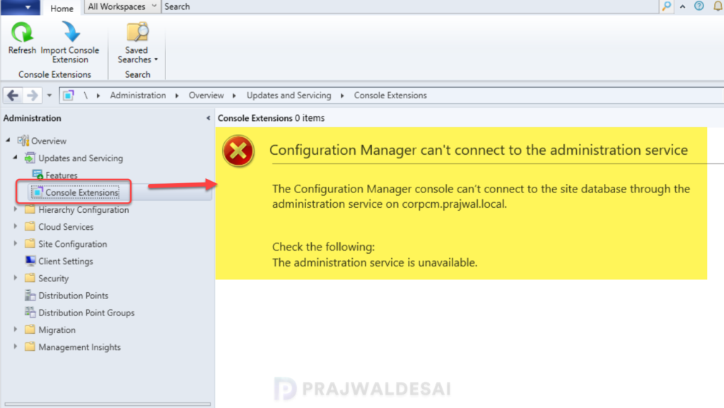

Recently, I encountered an error message when I tried to access Administration > Overview > Updates and Servicing > Console Extensions. The error message was “Configuration Manager can’t connect to the administration service. The Configuration Manager console can’t connect to the site database through the administration service on the server. Check the following: The administration service is unavailable.”
This error indicates that the ConfigMgr console can’t reach the SMS Provider or Administration Service endpoint on your site server. Some common causes for this error are as follows:
  1. SMS provider issues
  2. Problems with IIS Configuration
  3. Certificate issues such as certificate expired, etc.
  4. Failed or incomplete SCCM upgrade
Configuration Manager can't connect to the administration service

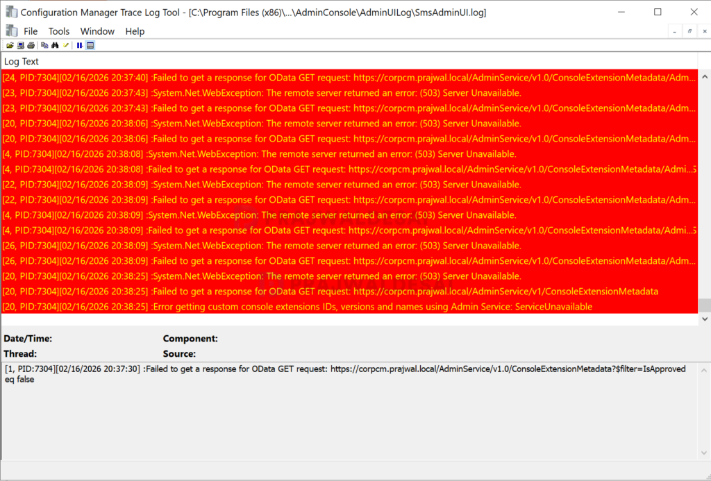

In my case, I had problems with the administration service, and the SMSAdminUI.log showed the following errors:
[1, PID:7304] System.Net.WebException: The remote server returned an error: (503) Server Unavailable.
[1, PID:7304] Failed to get a response for OData GET request: https://corpcm.prajwal.local/AdminService/v1.0/ConsoleExtensionMetadata?$filter=IsApproved eq false
Failed to get a response for OData GET Request

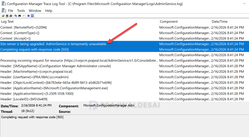

The administration service logs its activity to the adminservice.log file on the SMS Provider server in the Configuration Manager installation directory. I noticed the following lines in the log file.
Site server is being upgraded. AdminService is temporarily unavailable.
Completeing request with response code [503]

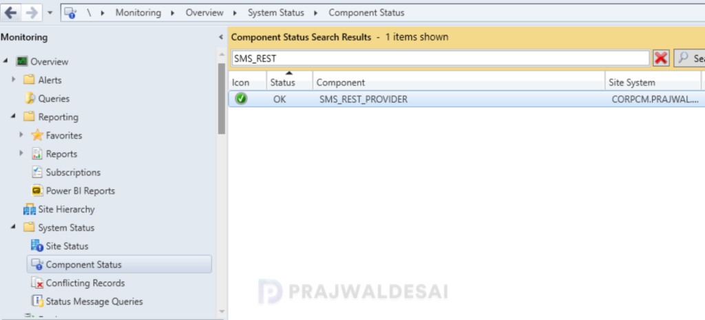

To check if the SMS_REST_PROVIDER component is healthy, open the console and go to Monitoring > Overview > System Status > Component Status and look for SMS_REST_PROVIDER. A green circle with a tick signifies that the component is active and functioning properly.
Verify the SMS Provider Is Healthy

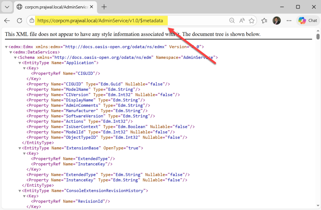

One of the basic troubleshooting steps for troubleshooting the administration service is to check if the admin service is responding to HTTPS. From a browser on your workstation or on the primary server itself, open a browser and access the below links.
  • https://<PrimaryServerFQDN>/AdminService/v1.0/
  • https://<PrimaryServerFQDN>/AdminService/v1.0/$metadata
If you still get 503, that’s almost certainly IIS/app pool on the primary server.
Check if the admin service is responding to https

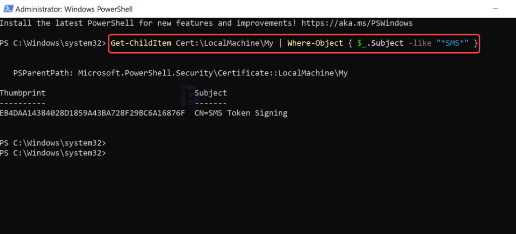

Ensure the server has a valid server authentication certificate. If using Enhanced HTTP, verify the SCCM-generated certificate is valid. Open the PowerShell as administrator and run the below command.
Get-ChildItem Cert:\LocalMachine\My | Where-Object { $_.Subject -like "*SMS*" }
Verify SCCM generated certificate
