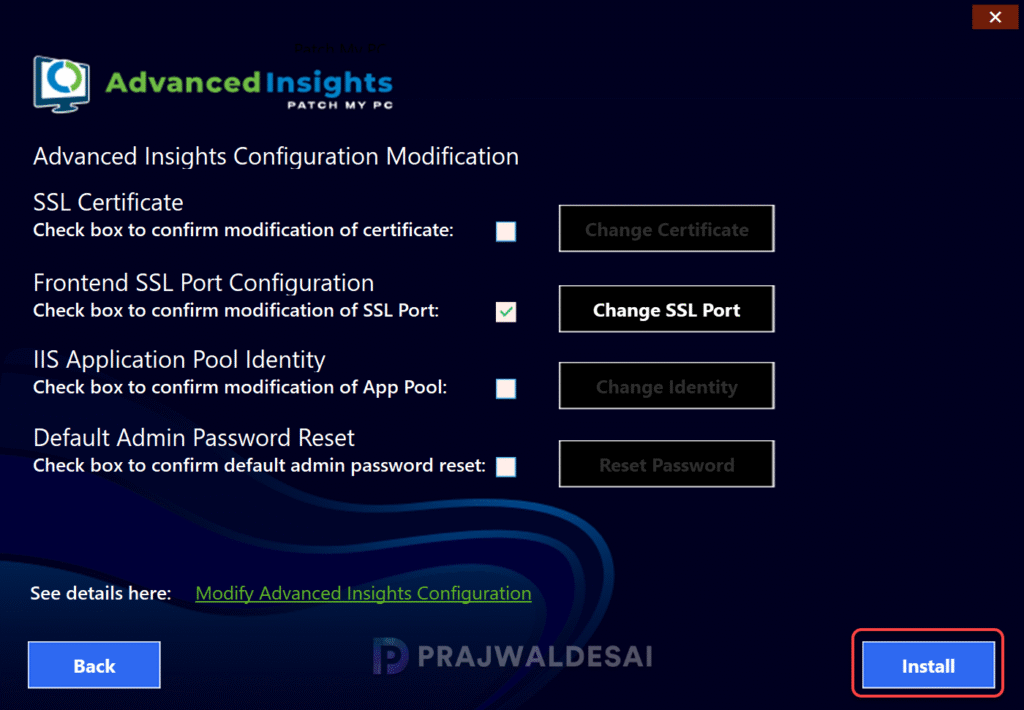

If you have a web browser accessing the Advanced Insights dashboard, close it. Next, go to Settings > Apps, click Advanced Insights app and select Modify. On the Modify, Repair or Remove installation wizard, select Modify as shown in the below image.

Look for the setting ‘Frontend SSL Port Configuration‘ and click Change SSL Port.

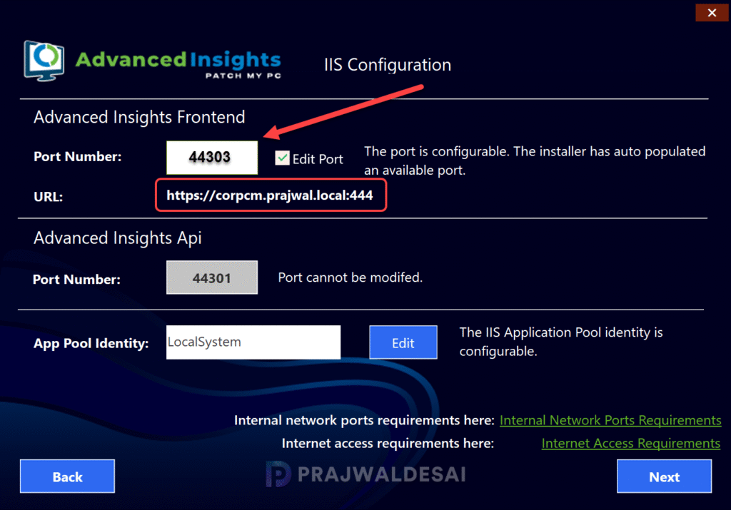

On the IIS configuration page, click “Edit Port” and specify the port number for Advanced Insights Frontend. For my lab, I have modified the frontend port from 444 to 44303. Click Next.

Click on Install to update the configuration.

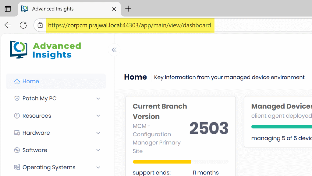

To verify if the new SSL port is used, launch the Advanced Insights tool. In the web browser, you will notice that the dashboard URL (https://corpcm.prajwal.local:44303) now uses the custom port that you specified in the above step.
