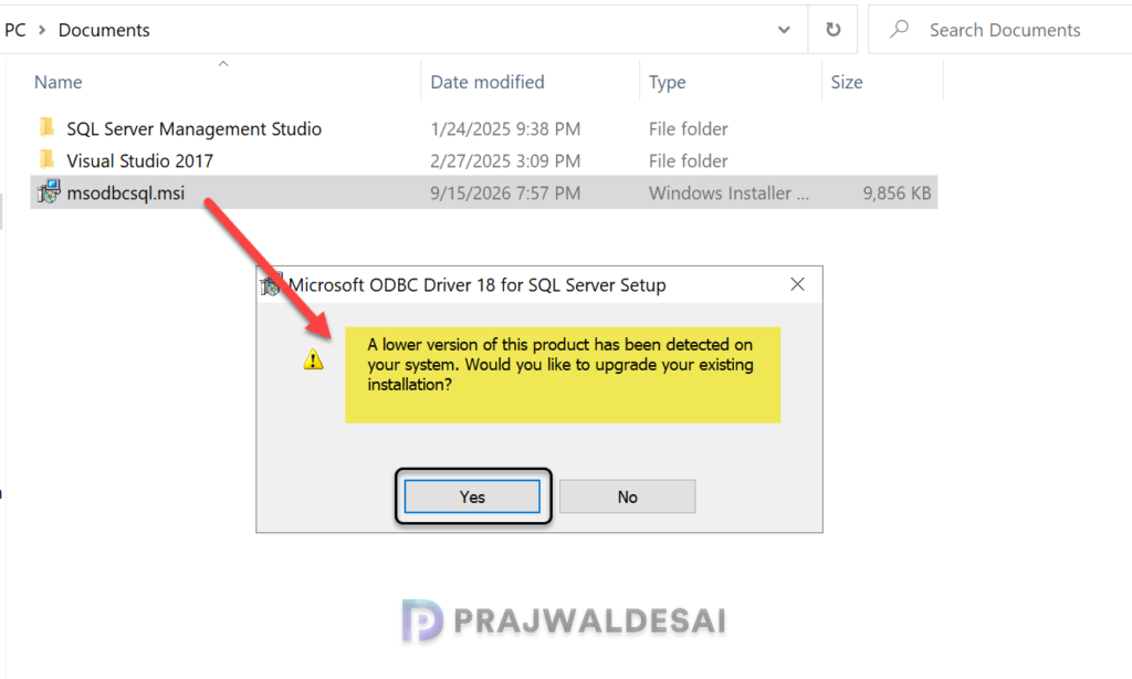

Whenever you attempt to install a newer version of ODBC driver for SQL server, you would see a warning “A lower version of this product has been detected on your system. Would you like to upgrade your existing installation?“. Select Yes to proceed.

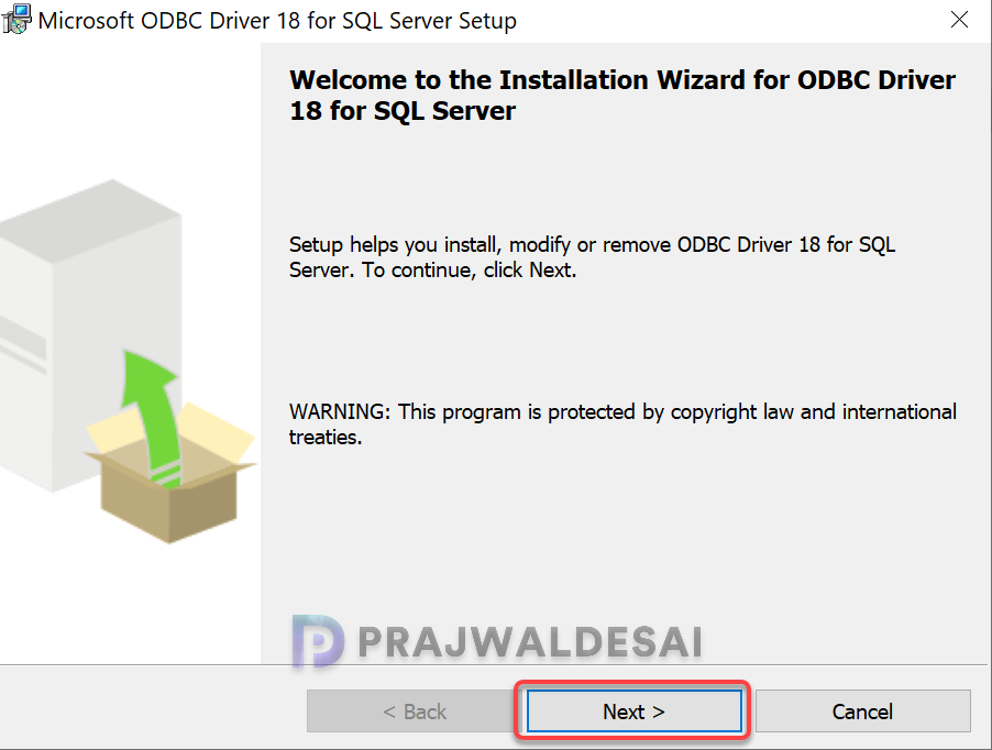

On the welcome page of the installation wizard, click Next.

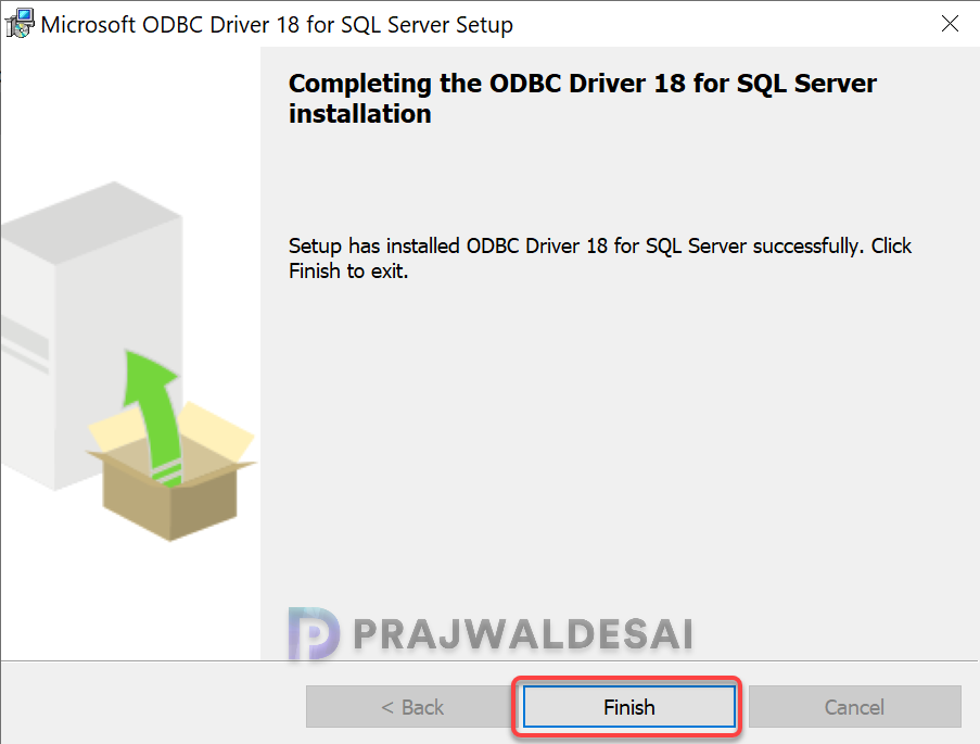

Accept the license terms and click Next. Complete the remaining steps and close the wizard.

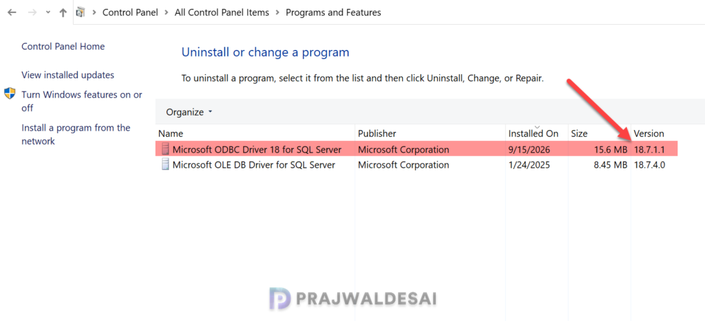

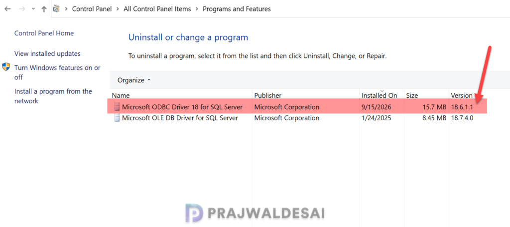

To check the installed version of ODBC driver for SQL Server installation, go to Control Panel\All Control Panel Items\Programs and Features. In the list of installed programs, locate the ODBC driver for SQL Server and look at the version column to find the installed version.
In the below image, we see the ODBC driver version is now updated to 18.7.1.1. I recommend restarting the server once post the upgrade is done.
